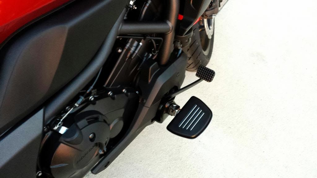

Lacking the equipment to do a mod like cobraguy I opted for the bolt on approach. Purchased these Kury Mini Boards and spline adapters for my wife so she can have a little more comfort. I had put them in her Shadow Aero which shares the same pegs as the CTX and she really liked them. Total cost apx 85.00

No road test yet but they have the same height clearance and are about the same width as the factory pegs. Raining all weekend, will update but visually looks like a lot of clearance to me. Frame lower on the Shadow and really had to push it hard for them to scrape. Also they do retract just like the factory pegs.

The only hard part is trimming about 3/16 off the inside factory spring with a Dremmel to make installing the adapters easier.

Those boards will work, they use the same splined adapters I used. They just have two more lower adjustment options. A word of advice, remove the original pegs SLOWLY and take notice of the spring orientation. It will be next to impossible to install the adapters unless you trim about 3/16 off the long straight portion of the spring with a dremmel or good cutters.

Since jinete seems to be MIA, attached is a pic of the 4357 boards I just installed. Couldn't get the pin through the mounts with springs inserted even after trimming so goodbye springs. I used the mounting holes that move the board rearward as much as possible.
If I hang my boot heel off the rear edge of the board (like you would a footpeg) it's effectively moving the foot position back a whopping 5 and a half inches - into standard riding position territory (yippee!). I'm 5'7" with a 30" inseam. In this new riding position my knees still have room under the fairing. When lifting to reach for the rear brake or shifter the knees sometimes lightly bump the fairing. Hence, if you have more than a 30" inseam and a faired bike I would not recommend these boards. The minis would be a better choice.
The new seating position will take some getting used to relative to using the controls but when cruising it feels much more comfortable and natural to me.

I have the mini boards and can't get the pin through with the trimmed spring either. I put the original pegs back on and had no problem putting the pins in with the spring. I wondered if leaving the springs out would have a major effect on them. Any problem if I do leave them out?
