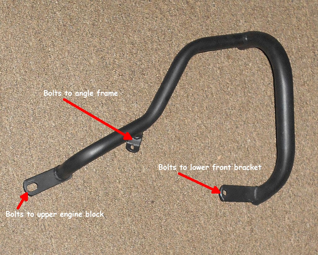

Here is what the bars look like out of the box:

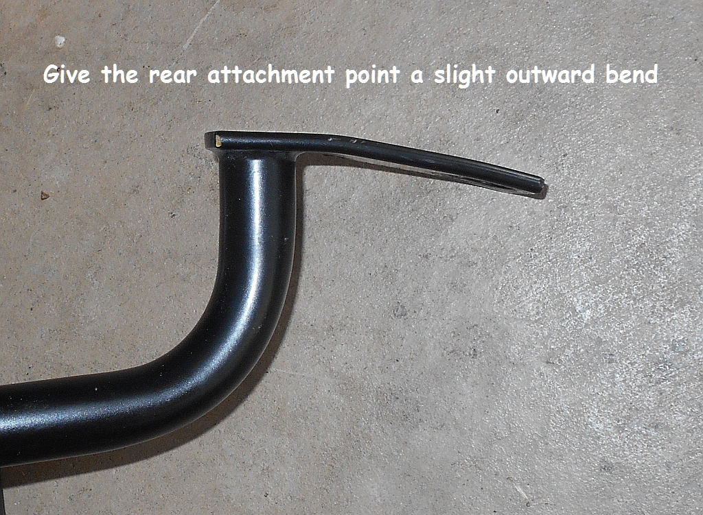

These bars are pretty much mirror images of one another with each having 3 points of attachment to the frame. Starting from the back of the bike, the stock bolts at the top of the engine case will be re-used (but I added lock washers). Although according to the parts drawings, the naked version of the radiator covers looked like they might have worked better (if they fit), I decided to make the fairing version work by changing the angle of the bar mountings. The first step to accomplish this involved putting a slight bend in the rear attachment point as shown below:

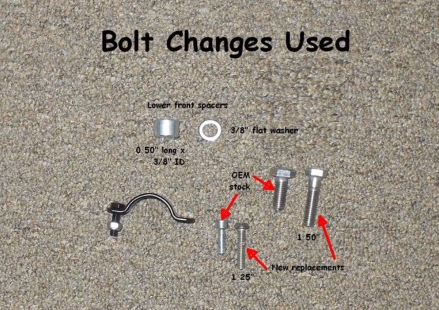

The next two mounting points will involve some changes in the bolts used.

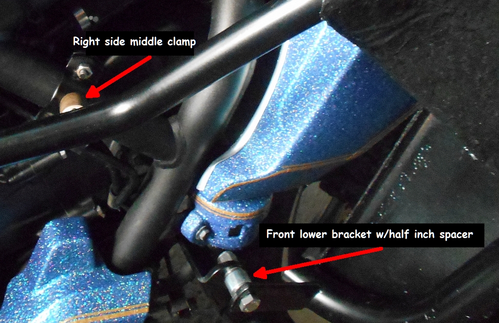

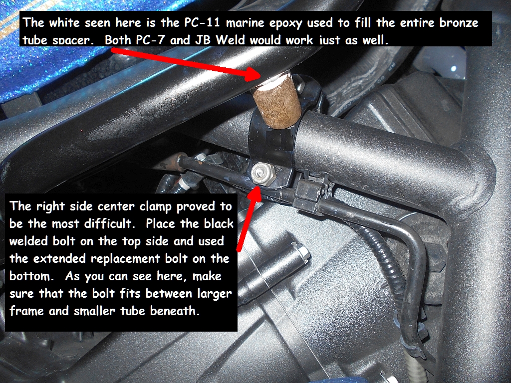

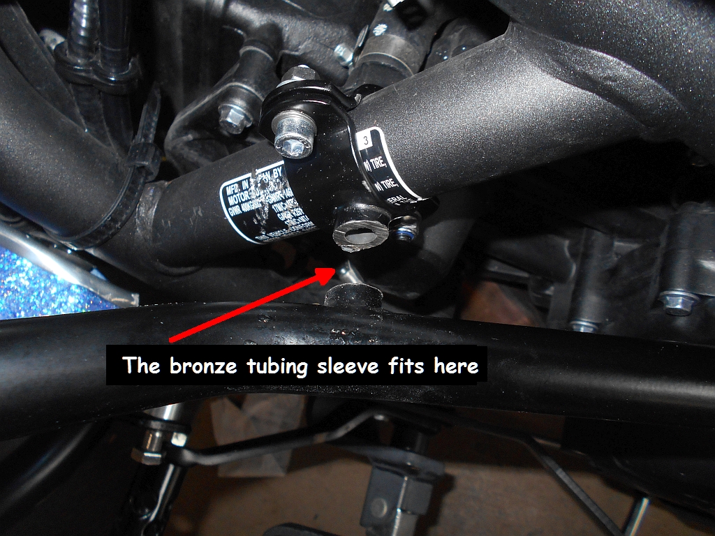

The real work involves the two part clamp welded on a post. The major modification for these clamps was to cut them and add the bronze spacers as pictured below:

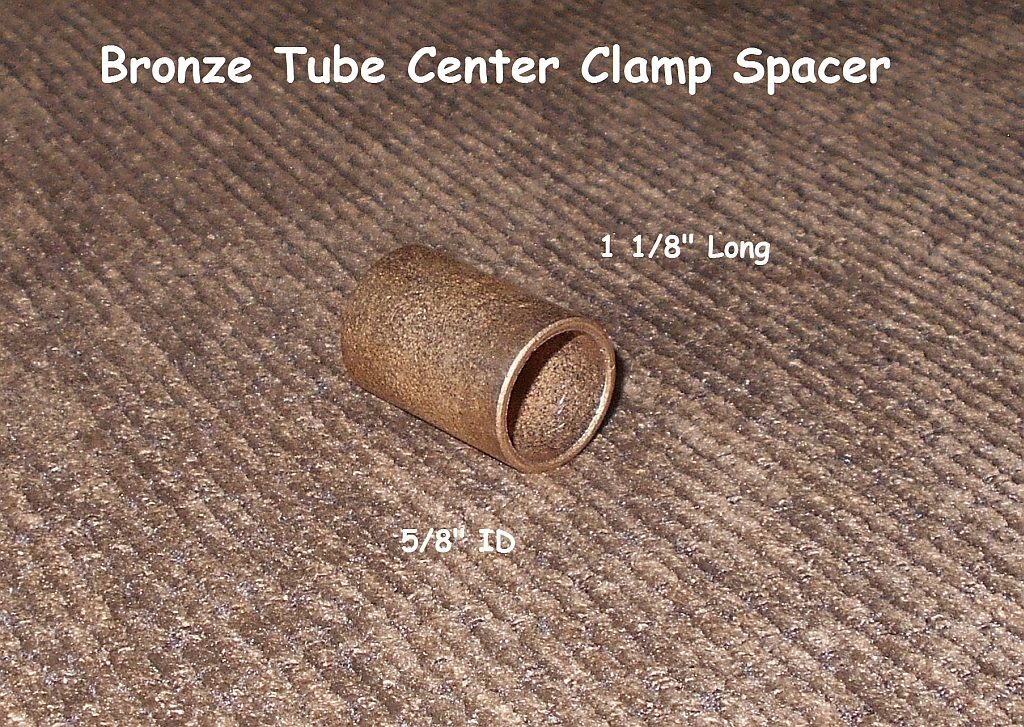

Since I am only concerned with these bars providing me accessory brackets, I opted to save the expense of getting them welded. This is why I used 1.125” bronze spacers glued in place instead:
NOTE: If you want to retain the full protection function, you should use steel tubing here and have it professionally welded.
Using the above hardware changes, the left side install was a breeze. Getting the center clamp just so on the right side was the only PITA and took up about a hour of fooling around which was about 50% of the total time involved.

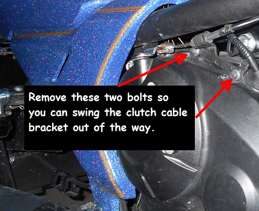

BTW, when removing and installing the rear bolt on the right side, I removed the bracket that holds the clutch cable in place so that I have easy access:

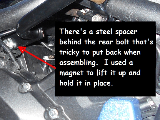

Of course, you DCT folks don't have to worry about that! The other issue regarding that rear bolt is re-positioning the floating spacer in there. I tried several things before discovering that a 2" X 0.75" X 0.375" magnet worked very nicely to hold it steady:
